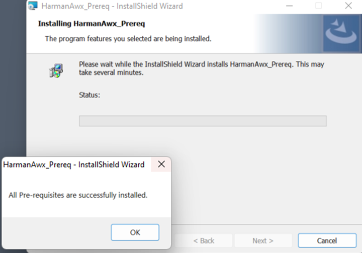

Install AudioworX Prerequisites
Follow the below steps to install AudioworX prerequisites setup.

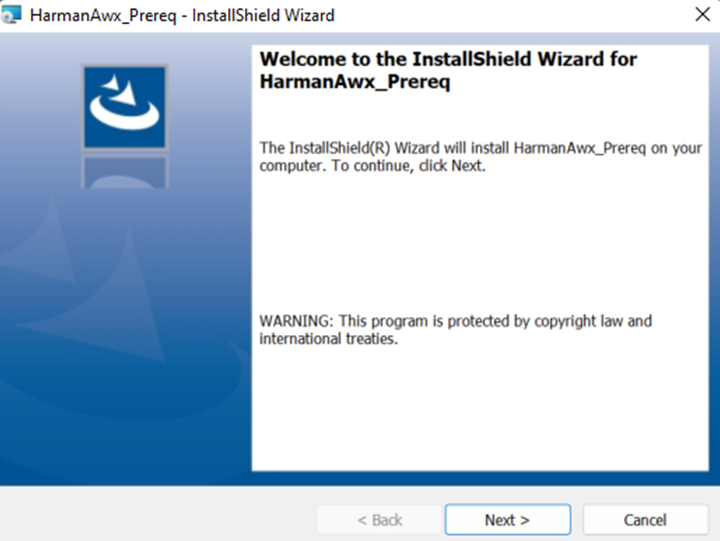

  1. Right-click the HarmanAudioworX Pre-req setup file and choose Run as administrator.
    The AudioworX prerequisites setup file must be run as administrator. Certain Global Tuning Tool features may not work properly if you run the AudioworX prerequisites setup file normally.
    If you see the User Account Control prompt that says, Do you want to allow this app to make changes to your device? select Yes.
  2. On the HarmanAwX_Prereq welcome screen, click Next.

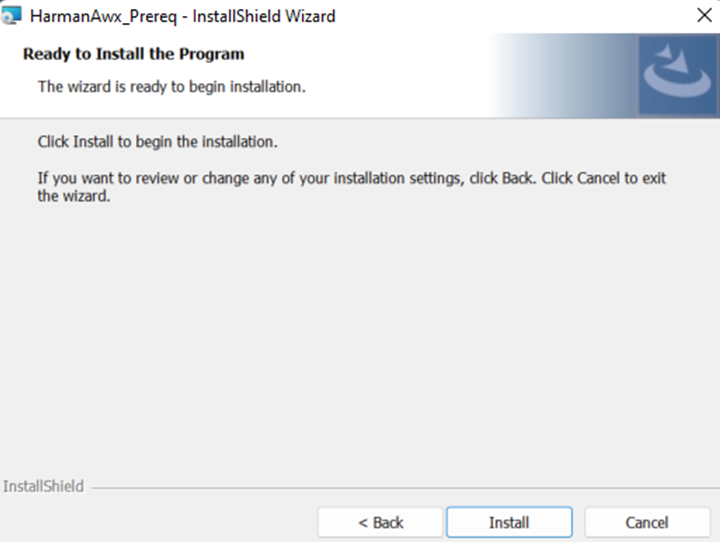

  3. Click Install to start the installation.
  4. When all the prerequisites are successfully installed, the installation wizard will display a message, and click OK to continue the installation.
  5. Click Finish to complete the installation.

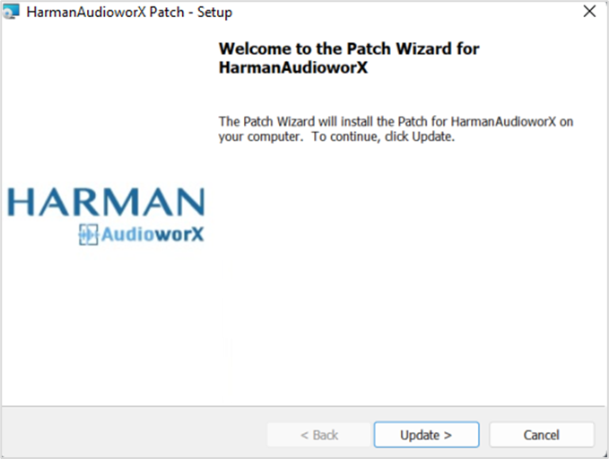

Install Patch
Install the AudioworX patch file only after completing the AudioworX installation.
Follow the below steps to install the AudioworX patch setup.
  1. Right-click on the AudioworX patch and choose Run as Administrator.
  2. On the AudioworX patch wizard welcome screen, click Update.
    Wait till the installation wizard completes the upgrade.
  3. Click Finish to complete.

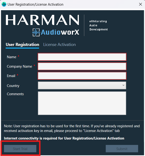

Global Tuning Tool Trial License
A trial license gives you full access to the Global Tuning Tool for 90 days. At the end of the trial period, Global Tuning Tool will notify you and you’ll have the option to request a full license to continue using it so that you won’t lose any of your projects or data.
The Global Tuning Tool offers a one-time trial license. Once the trial period ends, you cannot extend or renew it on this machine. You’ll need to purchase a license for continued use.
To request a Global Tuning Tool trail license.
  1. Double-click on the Global Tuning tool to start.
  2. Enter the following user registration details on the User Registration/ License Activation screen.
    • Name: Enter your name.
    • Company Name: Enter your company name.
    • Email: Enter your official email ID.
    • Country: Select your country from the drop-down list.
    • Comments: To add additional requirements or a custom license.
      Fields which are marked with * are mandatory.
      No special characters are allowed in user registration fields.
  3. Click Start Trial.
The Global Tuning Tool will launch. On the home page, you can verify the validity of your license.
Go to the right side of the GTT landing page and click on the ellipsis icon. Click “Know your GTT license status”.

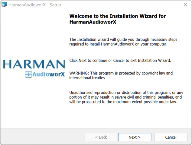

Install AudioworX Installer
Follow the below steps to install the AudioworX setup.
  1. Right-click the AudioworX setup file and choose Run as administrator.
    The AudioworX setup file must be run as administrator. Certain Global Tuning Tool features may not work properly if you run the AudioworX setup file normally.
  2. On the AudioworX welcome screen, click Next.

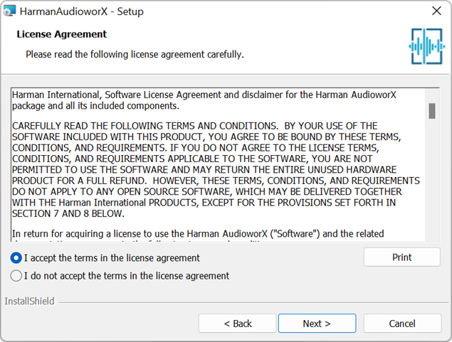

  3. On the License Agreement screen read the license agreement carefully, accept the terms of the license agreement, and click Next.

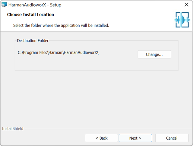

  4. On the destination screen, click Next if you accept the default destination folder location.
    The default location is C:Program FilesHarmanHarman AudioworX.
    click Change to set a different folder.

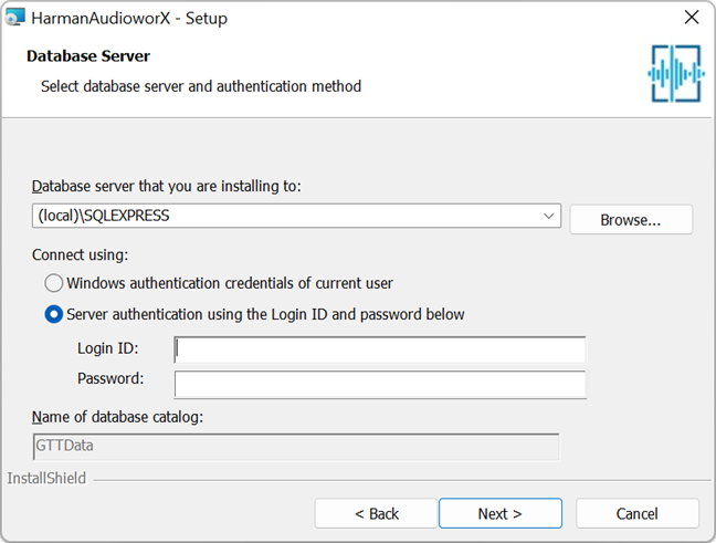

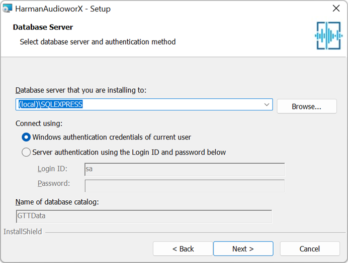

  5. On the server screen, connect to the server using one of the following options.
    By default, the wizard will connect to your local server.
    Select the Windows Authentication option and click Next.
    In this authentication mode, the wizard will automatically connect to your local server using your Windows authentication.
    Select the Server Authentication option, enter the Login ID and Password, and click Next.
    Use server authentication mode only if the server is available on the computer. Make sure you have server credentials details with you.

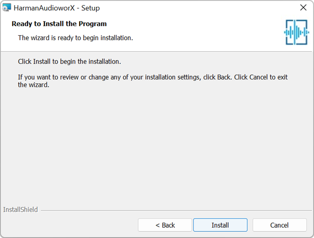

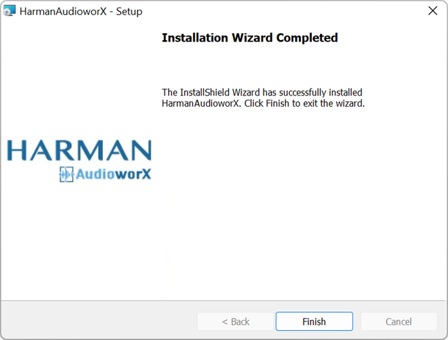

  6. Click Install to start the installation.
  7. Click Finish to complete the installation.

User Registration
Follow the below steps to complete the Global Tuning Tool user registration.
  1. Double-click on the Global Tuning Tool to start.

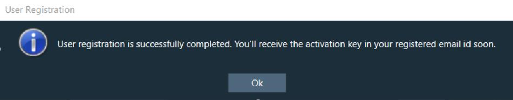

  3. Click Submit.
    After submitting registration details, the GTT displays a message “User registration is successfully completed. You’ll receive the activation key in your registration email ID soon.”
  4. Click Ok.
You will receive the activation key on your registered email ID within 24 hours on a working day.

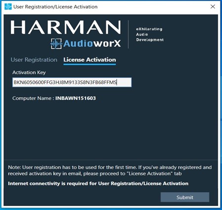

License Activation
On receiving the activation key over email, you need to activate the license.
Follow the below steps to activate the license.
  1. Double-click on the GTT to start.
  2. On the User Registration/ License Activation screen, select the License Activation tab.
  3. Enter the activation key and click Submit.
    On successful activation, the GTT will open and the GTT license activated successfully message displayed.

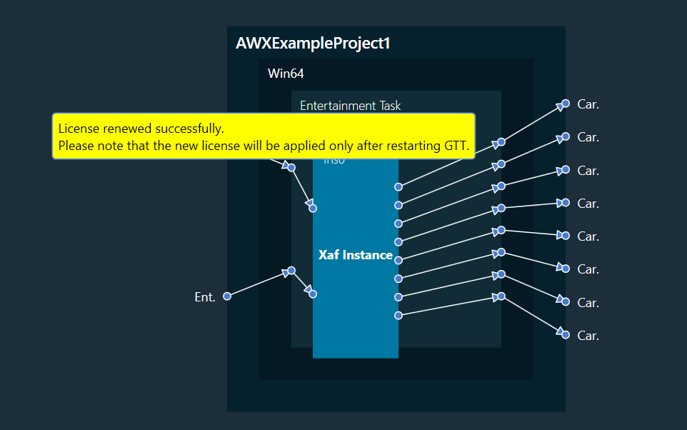

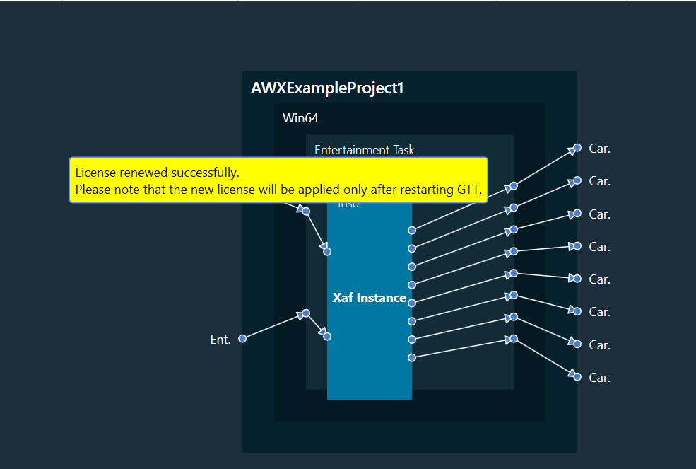

Renew License
You might see the “Renew GTT license” message on your GTT platform landing page or dashboard. This happens due to an upcoming expiration date of the GTT license.
The latest GTT license includes new features and extended license validity.
Follow the below steps to renew the GTT license:
  1. Open the Global Tuning Tool and navigate to the Home screen.
  2. Select the Renew License option.
The system will start downloading the latest license. The GTT platform notifies you after a successful license renewal.

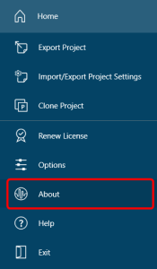

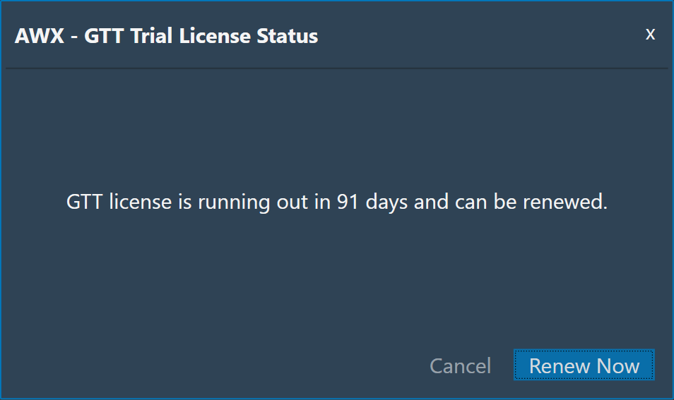

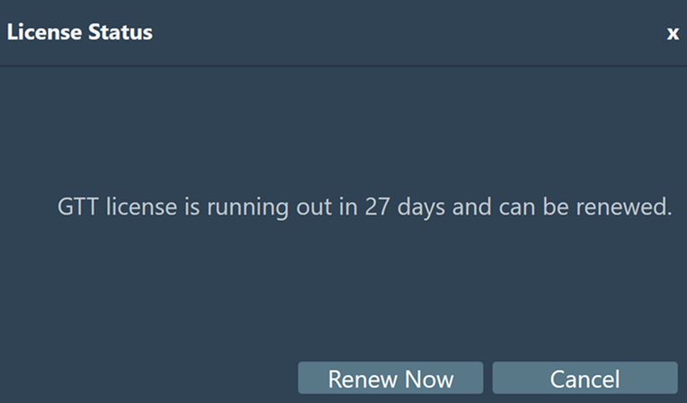

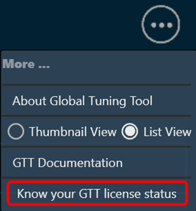

License Status Check
After you have renewed your GTT license, you can verify the validity of your license.
  2. Go to the right side of the GTT landing page and click on the ellipsis icon.
  3. Click Know your GTT license status.
The GTT license status is displayed.
If you want, you can renew your GTT license by clicking on Renew Now.
Also, you can get the GTT license status from the File menu. Go to the File menu and select the About option from the drop-down menu.
You will only be able to access licensed features in the GTT Platform. A message “Feature is not licensed” will appear if you attempt to use a feature for which you do not have a license.

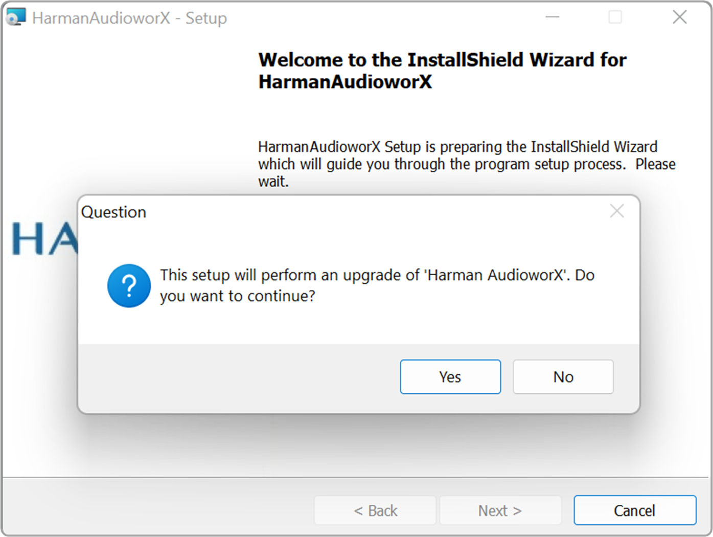

Upgrading AudioworX
Follow the below steps to upgrade AudioworX.
    The AudioworX setup file must be run as administrator. Certain Global Tuning Tool features may not work properly if you run the AudioworX prerequisites setup file normally.
  2. Click Yes to confirm the Harman AudioworX setup upgrade request.
  3. On the AudioworX welcome screen, click Next.

  5. On the destination screen, click Next if you accept the default destination folder location.
    Or click Change to set a different folder.

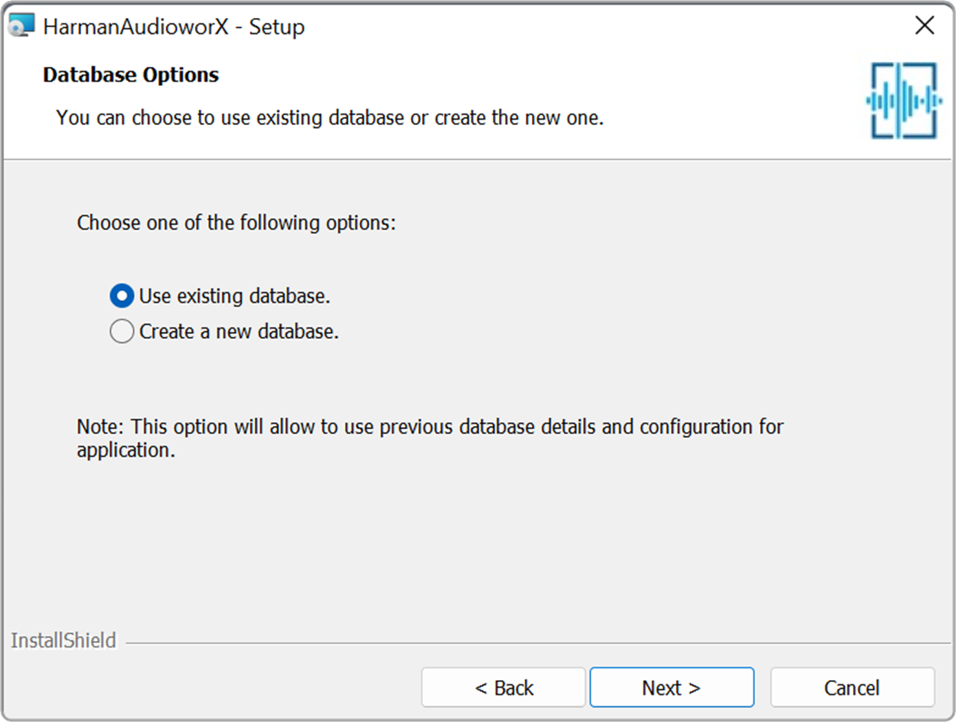

  6. On the database options screen, select any of the options Use existing database or Create a new database, and Next.
    If you select Create a new database option, then you need to configure the database server.
    If you select the Use existing database option, then the setup will continue with the existing database configuration.
  7. On the server screen, connect to the server using one of the following options. (Only applicable if you select Create a new database).
