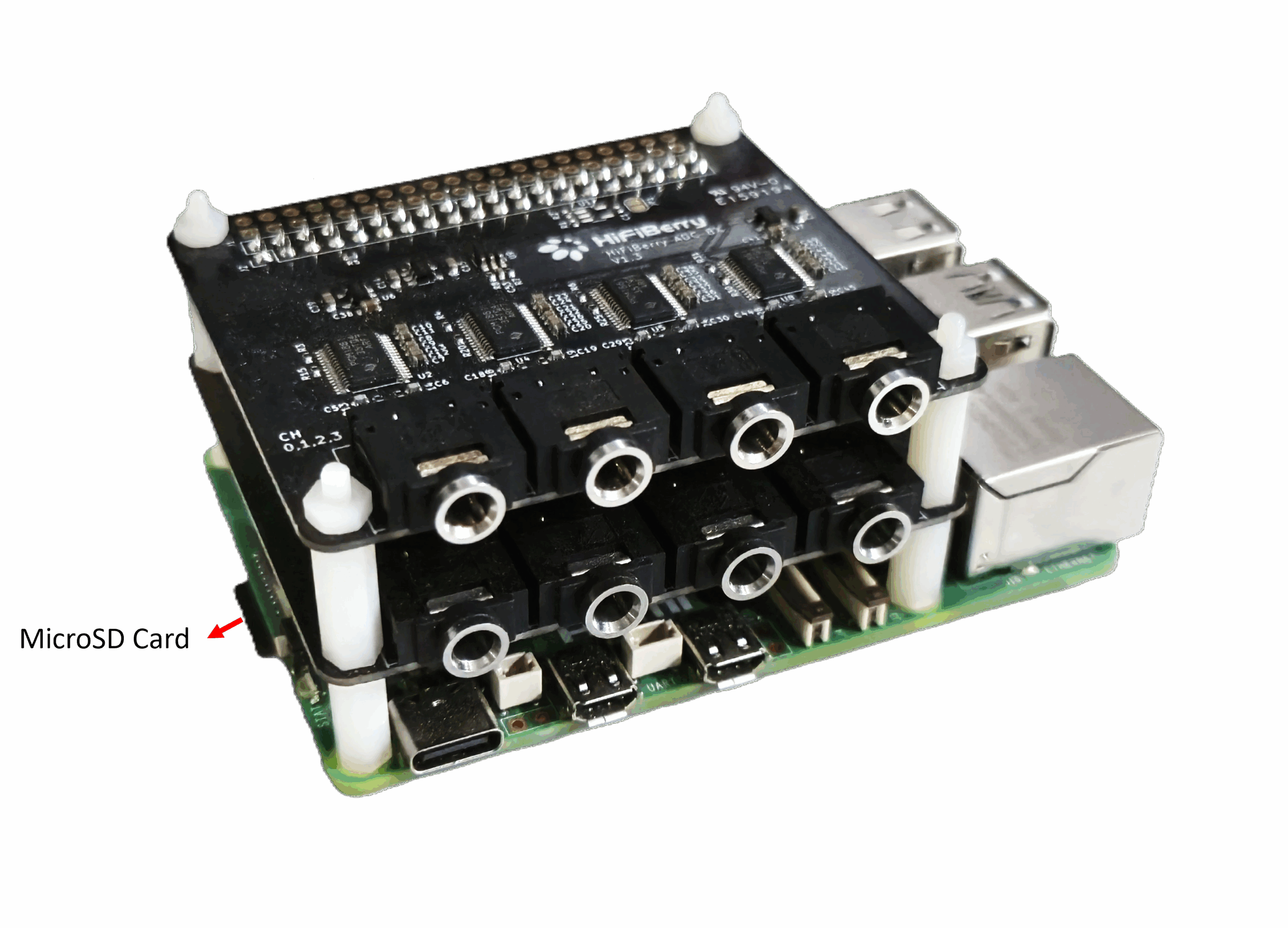

Assembling the HiFiBerry HATs on to the Raspberry Pi 5
In the latest version of the AudioworX Starter Kit, the HiFiBerry DAC8x (8-channel line audio input HAT) and the HiFiBerry ADC8x Add-on (8-channel line audio output HAT) are the default and recommended audio interface for the setup’s compactness, robust interfacing and multi-channel capabilities.
The HiFiBerry HATs must be stacked on top of the Raspberry Pi 5 (the bottom-most layer in the stack) using the 40-pin header in the given order:
  1. HiFiBerry DAC8x (middle layer in the stack) on top of the Raspberry Pi,
  2. HiFiBerry ADC8x Add-on (top-most layer in the stack) on top of the DAC8x.
Observe caution when stacking the HATs. Disconnect the power from the Raspberry Pi 5 before installing the HATs.
It is important that the pins perfectly align with no open pins visible upon installation. Use the plastic spacers provided with the HiFiBerry HATs to ensure that the hardware is secured in place and does not budge while connecting cables to the audio input and output ports.
The below figure shows a complete Starter Kit setup.
A Fully Setup AudioworX Starter Kit (Bottom Layer: Raspberry Pi 5, Middle Layer: HiFiBerry DAC8x, Top Layer: HiFiBerry ADC8x Add-on)

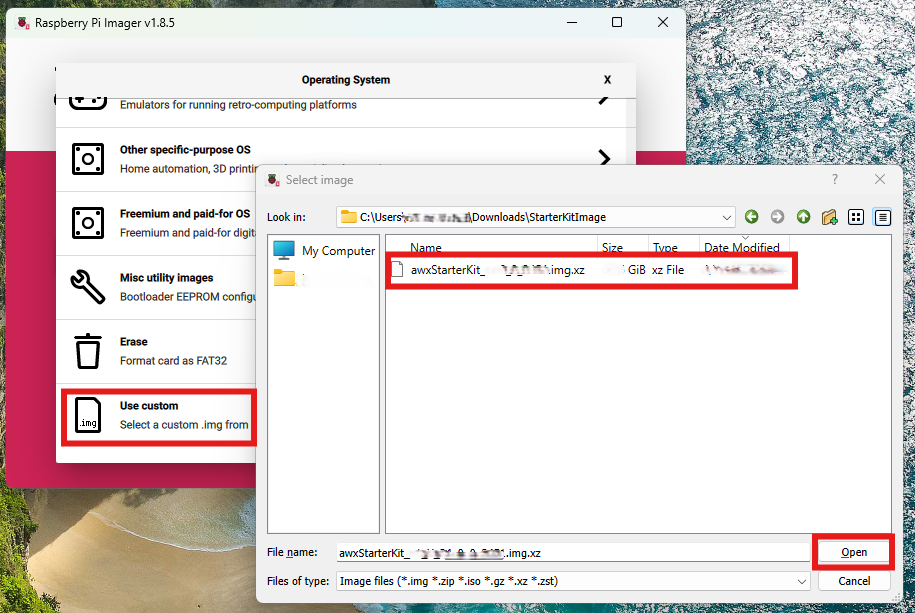

  1. Mount the SD card in the card reader and plug it into your PC for flashing.
  2. Open the Raspberry Pi Imager. Under “Device”, select the “Raspberry Pi 5”.
  3. Under “Operating System”, click “Choose OS”, scroll down and click “Use Custom”.
  4. In the pop-up, browse for the downloaded image file and select it.
  5. Now, in the main Raspberry Pi Imager window click the “Choose Storage” button, select the mounted drive to be flashed and click “next”.
  6. The Imager will then show a prompt for OS customizations. Click on “Edit Settings”.

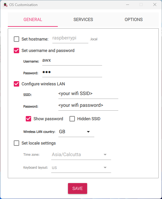

  7. In the OS Customization → General tab (shown below):
    1. Enter “awx” in both the username and password fields. Alternatively, users may enter a username and password of their choice and use the same in the SKUtility to login to the Starter Kit later.
    2. (Optional) If direct ethernet connection between the Raspberry Pi and the PC is not possible:
      1. Tick the check box “Configure Wireless LAN” and enter your home Wi-Fi/mobile hotspot credentials in the SSID (Wi-Fi name) and password fields,
      2. Specify the Wireless LAN country code according to the country that the Starter Kit is being used from the drop-down menu. Here, it is set to GB (Great Britain).
        Direct ethernet connection between the PC and the Raspberry Pi is recommended for stable connection to the Starter Kit. Refer to the Troubleshooting Guide for alternative ways to establish connection between the PC and the Raspberry Pi.

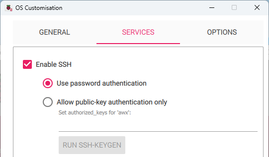

  8. In the “Services” tab, enable SSH login and click “Save”.

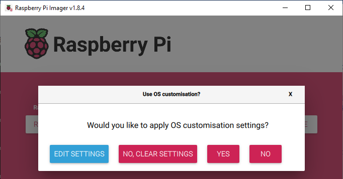

  9. In the following window, click “Yes” to apply OS customizations.

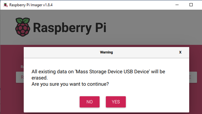

  10. You might see a warning (shown below). Click on “Yes” to continue.
  11. Once the image has been flashed, eject the MicroSD card from the card reader, insert it into the Raspberry Pi’s Micro SD card slot on the underside (shown below) and power it on.

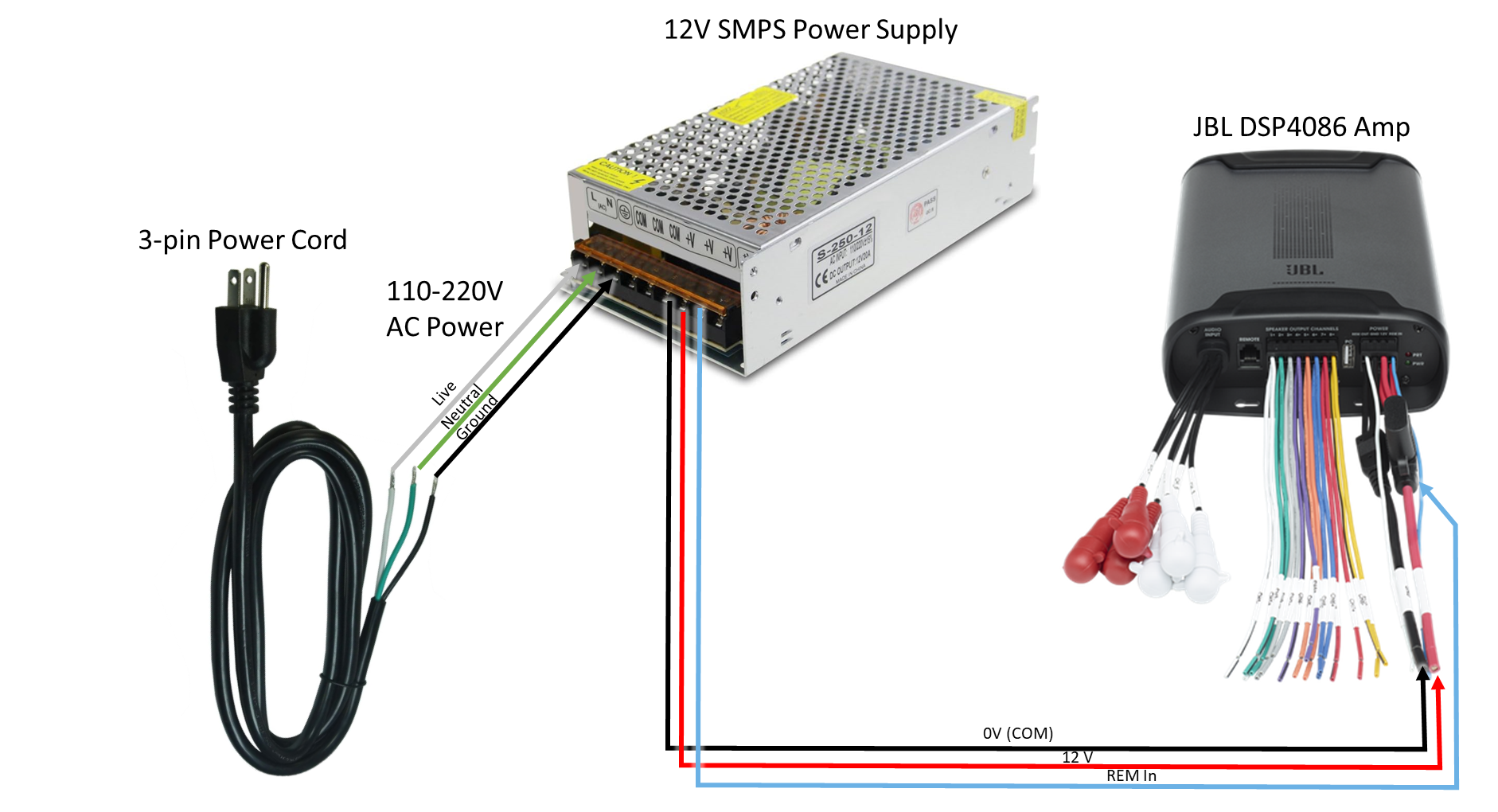

  2. Power up the amplifier as follows:
    1. Connect the SMPS power supply’s AC power input using the 3-pin Power Cord (exact connections shown in the image below)
    2. Connect the Power Harness of the amplifier as follows:
      1. Red thick wire (+12V) to the +V port of the SMPS power supply,
      2. Black thick wire (0V COM) to the -V port of the SMPS power supply,
      3. Blue thin wire (Remote In) to the +V port of the SMPS power supply.
  3. Connect the amplifier to the PC via USB (USB cable supplied with the amplifier).

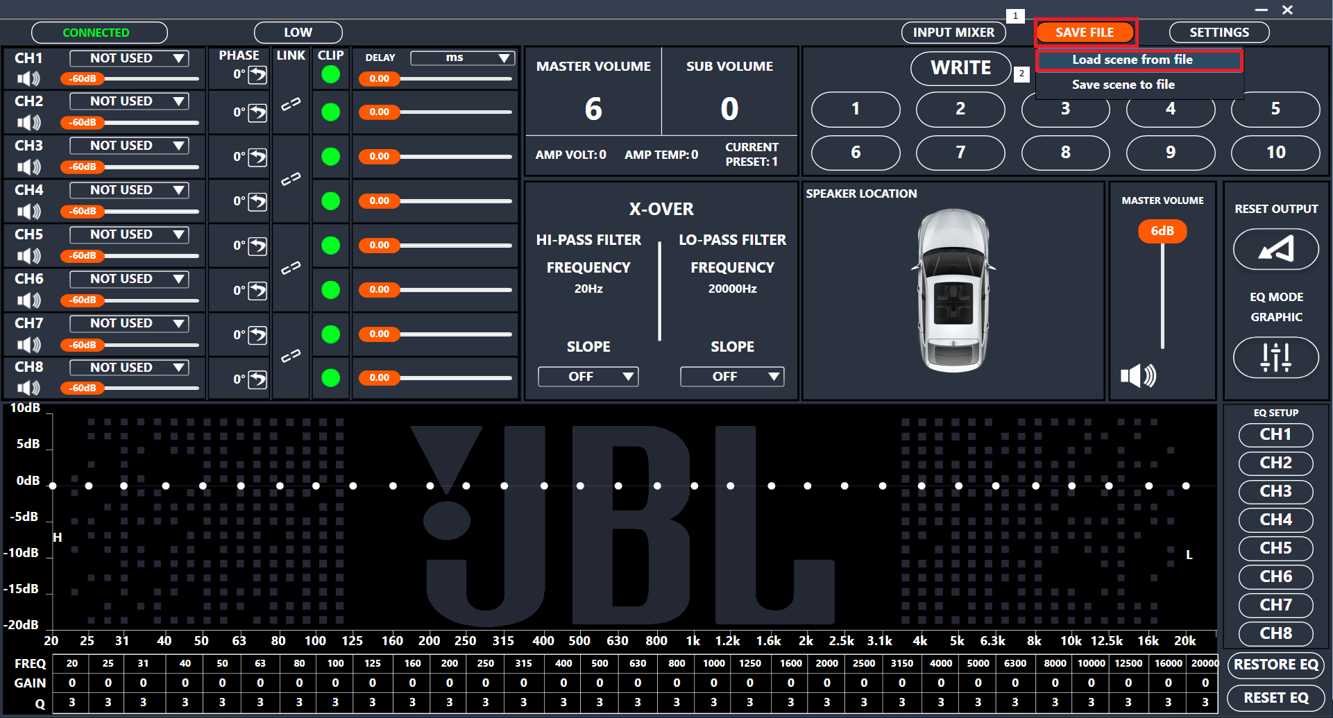

  5. Now, open the JBL/Infinity DSP application from the Windows Start menu. If the amplifier is properly connected, it will be clearly shown on the top-left of the application.
  6. Download the AWX_SKAmpConfig.bin file.
  7. Load the file from the “Save File → Load Scene” menu:
    In this configuration, output channels 7 and 8 of the amplifier are unused. They may be enabled to drive additional speakers with signals derived from the 6 input channels. For example, an additional sub-woofer or front stereo tweeters may be driven by the amplifier.
  8. Finally,
    1. Select preset “1” from the top-right preset list,
    2. Click the “Write” button,
    3. Select the first row,
    4. Click “Ok” in the renaming window,
    5. Click “Save” in the “Save as Default Scene” window to write the preset into the amplifier.

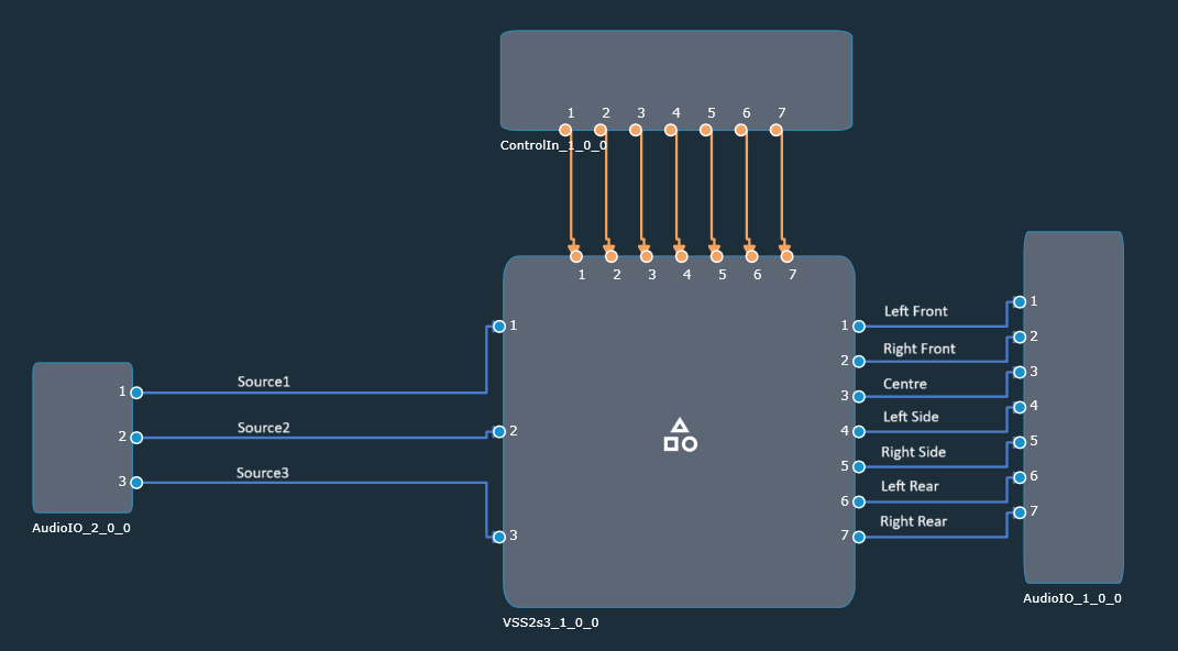

SFD of VSS 2.0
VSS 2.0 channel mapping
The below figure shows the internal signal flow of VSS 2.0.
VSS 2.0 internal signal flow

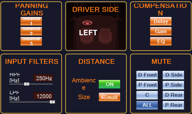

Virtual Sound Sources (VSS) 2.0 Panel
VSS 2.0 panel is divided into two areas, namely Global area and Source tab area as follows.
Global area is further divided into panning gains, driver side, compensation, input filters, distance and mute sections.
Parameter Name Description
Panning Gains These buttons launch the LUT native panels displaying the angle/amplitude panning curves for each output channel.
Driver Side The DS can be changed by clicking this field.
Compensation The buttons included in this section provide access to the native panels of the Delay, Gain and EQ AOs used in the Compensation feature.
Input Filters This section is used to shape the frequency range of the source signals.
Distance This section provides a switch for turning the Ambience signal “ON/OFF”. The Size button allows the user to change the room size to “Small/Large” based on two tuning presets for the ReverbLite AO.
Mute It exposes individual channel output state “ON/OFF”. It also includes a global switch for all-channel mute/unmute. The buttons follow a driver side or passenger side layout. Depending on the DS, D_Front will either represent L_Front in LHD case or R_Front in RHD case. P_Front represents R_Front and L_Front respectively. The same rule applies to the Side and Rear speakers.

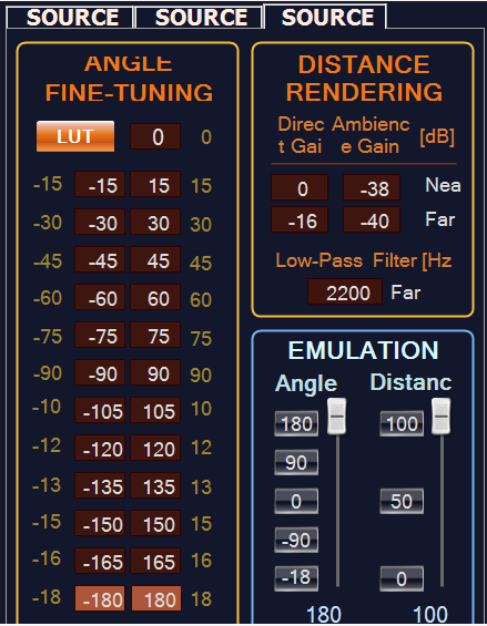

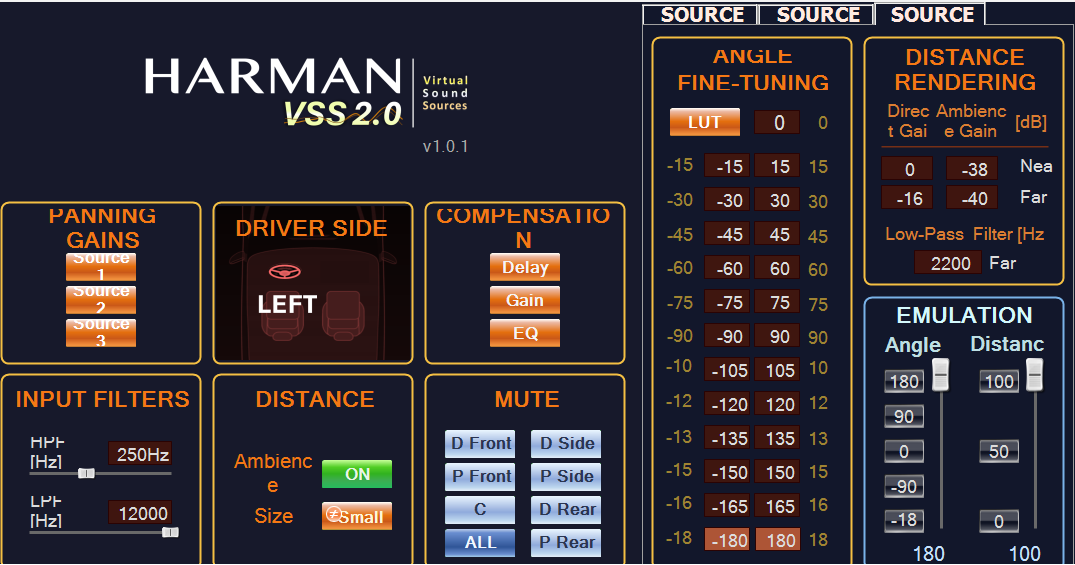

Source tab area is divided into angle fine-tuning, distance rendering and emulation sections.
Angles Fine-Tuning
It contain 25 angle support points to correct the angles for virtual sources located around the listener. The button next to the 0° angle correction point (SRC 1) opens the native panel of the LUT which is used only for copying and pasting the angles fine-tuning values from source to source.
Distance Rendering
This section allows to enter the attenuation values in dB for both Direct and Ambience signal, ranging between “Near” and “Far”. It also allows to define the lowpass filter cutoff frequency of the Input EQ for the maximum distance tuning (“Far”).
Emulation
This section is designed to allow the user to set and test per-source tuning. Buttons allow to change the angle and distance to discrete values. For distance, 0 refers to “Near”, 100 to “Far”.
The number of source tabs is same as the number of CAO supported input channels.
