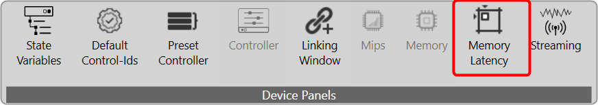

In the SFD when AudioObject is drag into panel, GTT will call getMemRecords() API to collect memory records details from the object to update the memory latency table. This will be repeated for all the AO’s of the SFD. Once the design is complete it shall be saved.
The user can open the memory latency editor and edit the latency levels. After saving the latency levels, if the object properties were edited and saved, the user will loose the saved latency levels for that object because GTT will call getMemRecords() again that will reset to default latency levels.
Graphical user interface, text, application Description automatically generated

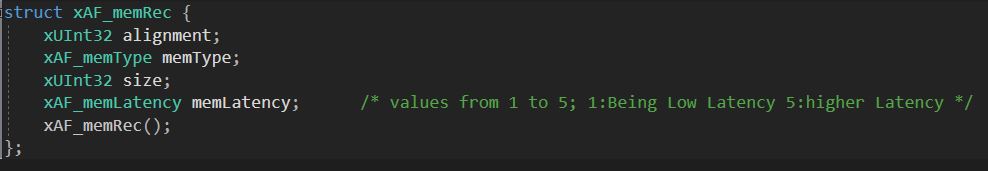

The elements of this table must be of the data type xAF_MemRec, which is shown below:
Member Description
alignment This is the required alignment for the memory region.
memType Type of the memory to be allocated – memType could be:
  • COEFFCIENT_MEM – This memory is used to store both tuning parameters and variables / buffers for internal usage by the audio objects.
  • SCRATCH_MEM – This memory is only used for temporary calculations.
size This is the size of the memory to be allocated.
memLatency This can take values from one to five where one – low latency and five – high latency.
