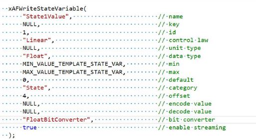

1. The XML section of the state variable has to be updated to convey that state variable is streamable to GTT. The optional variable after the bit converter has to be set to true to enable the state variable streaming.
The code snippet from CTemplate::getXmlObjectTemplate function conveys to GTT that the state variable “State1Value” is enabled for streaming by setting the optional variable after bit converter to true.

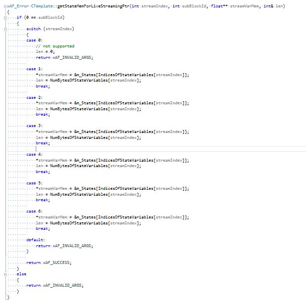

2. For uploading data from framework to GTT, the following public functions have to overridden or implemented:
  • CAudioObject::getStateMemForLiveStreamingPtr
  • CAudioObject::getDataFormatForLiveStreamingPtr
CAudioObject::getStateMemForLiveStreamingPtr () take in 4 arguments representing streamIndext, subBlockId, pointer to hold memory address of the state variable (stateMem) and the number of the bytes to be streamed (len).
The streamIndext and subBlockId are passed into the audio object to enable the calculation of which channel of the state variable to be streamed. Based on the calculation done, the audio object has to update the variables stateMem and len.
The code snippet from CTemplate::getStateMemForLiveStreamingPtr shows the example implementation. In this example code, subblock is not used for state variable and hence subBlockId has to be always zero. The first state variable (with streamIndex 0) is mute which is not enabled for streaming in XML file. The state variables (streamIndext 1 to 6) is enabled for streaming in XML file and stateMem and len is updated.
The len argument of the function getStateMemForLiveStreamingPtr conveys that how many bytes are going to be streamed. If only one float value is going to be streamed then value for len is 4. If n number of float values need to be streamed, then variable len has to be 4 times n. Also, audio object has to make sure that len number of bytes are allocated for the state variable and the starting address is assigned to stateMem variable.

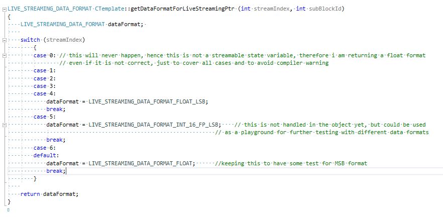

CAudioObject::getDataFormatForLiveStreamingPtr() take in 2 arguments representing streamIndext and subBlockId.
The streamIndext and subBlockId are passed into the audio object to return the data format of the state variable to be streamed.
The code snippet from CTemplate::getDataFormatForLiveStreamingPtr shows the example implementation. In this example code, subblock is not used for state variable and hence subBlockId has to be always zero. The first state variable (with streamIndex 0) is mute which is not enabled for streaming in XML file. The state variables (streamIndext 1 to 6) is enabled for streaming in XML file and the corresponding data format is returned from this function.
