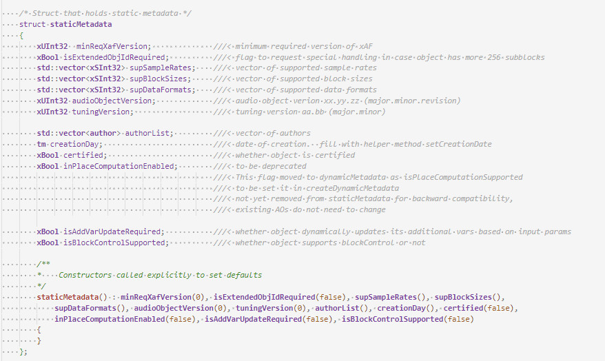

Static Metadata
The Static Metadata represents data that will not change based on configuration. It is provided as is.
There are two API methods related to this feature.
  • createStaticMetadata
  • getStaticMetadata
virtual void createStaticMetadata();
staticMetadata getStaticMetadata() { return m_StaticMetadata; }
Create Static Metadata
This method is intended to be overwritten by each instance of AudioObject. The goal is to populate the protected member m_StaticMetadata. There is an example of how to do this in AudioObject.cpp. The basic audio objects included within xAF also implement this method appropriately.
This method should be overridden by any object updating to the new API. Here are the relevant details:
  • minReqXafVersion – set this to an integer which is related to the major version of xAF. (ACDC == 1, Beatles == 2, etc)
  • isExtendedObjIdRequired – false for most objects. This flag enables support for more than 256 subblocks.
  • supSampleRates – list of all supported samples rates (leave blank if there are no restrictions)
  • supBlockSizes – list of all supported block sizes (leave blank if there are no restrictions)
  • supDataFormats – list of supported calcObject data formats (leave blank if there are no restrictions)
  • audioObjectVersion – Condensed three part version number. Created with helper method :
    • void setAudioObjectVersion(unsigned char major, unsigned char minor, unsigned char revision)
    • It is up to audio object to determine how to manage these versions.
  • tuningVersion – Condensed two part version number. Created with helper method :
    • Void setTuningVersion(unsigned char major, unsigned char minor)
    • These version numbers must only be changed when appropriate!!
    • Follow these rules:
      • Increment minor version when new release has *additional* tuning but previous tuning data can still be loaded successfully.
      • Increment major reversion when the new release is not compatible at all with previous tuoid setTuning data.
      • If tuning structure does not change, do not change this version
  • authorList – fill with list of authors if desired
  • creationDay – date of creation for the object
  • certified – whether this object has undergone certification
  • inPlaceComputationEnabled – whether this object requires input and output buffers to be the same (see below)
  • isAddVarUpdateRequired – whether the tuning tool should assume additional vars can change any time main object parameters are updated.
    • Set this to true if your additional variable sizes are based in some way on inputs.
    • Example: Number of Input channels is configurable by the user – and the first additional variable size is always equal to the number of input channels.
Get Static Metadata
This method simply returns a copy of m_StaticMetadata. It is not virtual.
In-Place Computation
This will be deprecated here and moved to dynamic metadata, to support a target/core specific implementation. The static member will be kept for backward compatibility reasons only and will be deprecated after some time.
Do not use this struct member in future implementations!

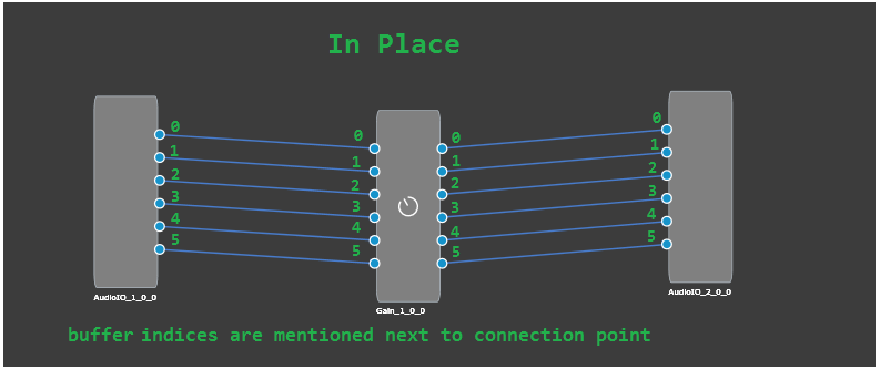

This feature allows Audio Objects to give the GTT the ability to operate in in-place computation mode. In this mode, the audio object uses the same buffers for input and output. This option has been moved from static metadata to dynamic metadata to support a kernel-based decision. This allows the AO developer to decide, based on the target architecture, whether or not it is beneficial to run the calc function in-place.
GTT analyses the signal flow and calculates the amount of buffers required for the given signal flow. If isInplaceComputationSupported is set by the audio object developer, GTT tells the framework to allocate only input buffers only.
The isInplaceComputationSupported flag can be checked in the the audio object’s dynamic metadata.
For example,  Gain configured for 6 channels :
  • If isInplaceComputationSupported is not set, it will use a total of 12 buffers.
  • If isInplaceComputationSupported is set, it will use a total of 6 buffers.
In-place computation feature has the following benefits:
  • reduces flash size.
  • reduces number of IO streams which improves the memory performance on embedded.
Current Limitation or Additional conditions
An Audio Object Marked is considered for in-place has to satisfy following three conditions:
  • Audio Object should have dynamic metadata flag isInplaceComputationSupported set to true for the selected core type.
  • Audio Object should have equal number of input and output pins.
  • All audio pins should be connected.
