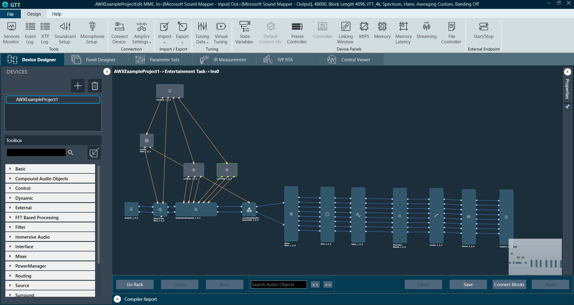

Signal Flow Designer
This feature enables users to design an audio post-processing pipeline using the basic audio objects.
Key features
    • Enables user to create audio post-processing pipeline.
    • Enables user to send the flow to the embedded device using “Send To Device”.
    • Enables user to add level meters to get RMS and Peak values of individual audio channels and control signals.
    • Enables user to measure MIPS and Memory on the given embedded platform.
    • Enables platform engineer to place the audio objects memory in specified.
    • Each individual object comes with a UI panel for an acoustic engineer to tune the audio post-processing pipeline.
For more details about Signal Flow Designer, refer to the Signal Flow Designer
