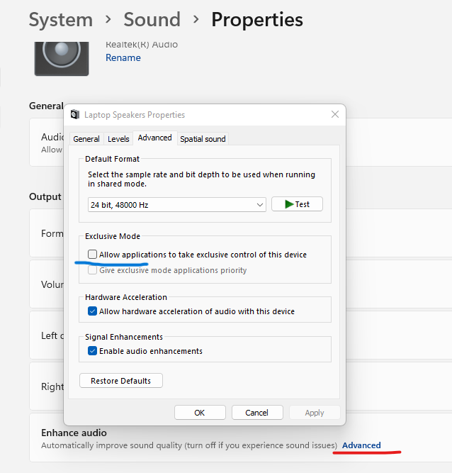

Q. GTT stops the audio from other application when launched?
A.  GTT doesn’t stops audio from other application, However If user face any such difficulty.
Change the properties of the sound settings in your laptop/ PC. Uncheck the check box which says, “Allow application to take exclusive control of device.”
