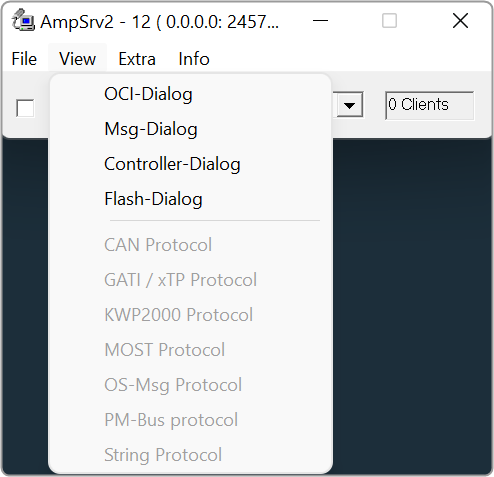

  • File: Click on the File menu to open the Options window or close the AmpSrv2.
  • View: Click on the View menu to open dialogues and protocols functionalities.
  • Extra: Click on the Extra menu to import CAN SID, OS-Msg Description, GATI/xTP Description, and Protocol file.
    Graphical user interface, text, application, chat or text message Description automatically generated
  • Info: To get the AmpSrv2 version and license details.
AmpSrv2 License
The AmpSrv2 dialogues and protocols functionalities are licensed-based. If any dialog or protocol is grayed out or not available, this means you have a limited license.
The AmpSrv2 is shipped with a limited license (Customer.lic).

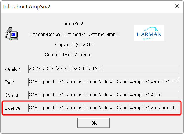

To check AmpSrv2 license:
  1. On the AmpSrv2 window, click Info, and then click About. This displays the AmpSrv2 info screen. Verify the license information.
    Graphical user interface, application Description automatically generated
To activate the new AmpSrv2 license:
  1. Navigate to the C:Program FilesHarmanHarmanAudioworXtoolsAmpSrv2.
  2. Locate the Customer.lic file (license file) and delete the existing license file.
  3. Copy and paste the new license file (xxx.lic) into the same AmpSrv2 directory.

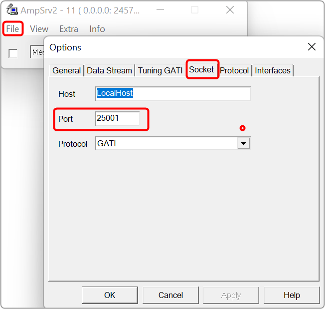

To changing AmpSrv2 Settings:

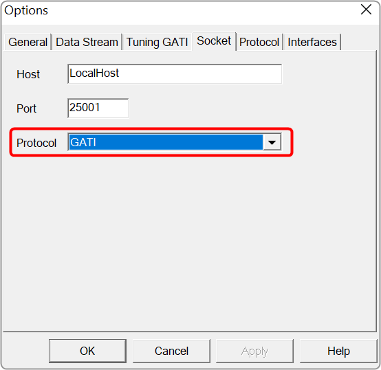

  1. On the AmpSrv2 window, click File, and then click the option. This opens the Options window.
  2. On the Socket tab, set the protocol to GATI.
If you experience network conflicts, choose a different port above 50000 because port 8080 is very popular. Your selection must appear in the VST client (probably AudioMulch).
  1. On the Tuning GATI tab, set the Databytes per to 192, and click Ok.
  2. On the AmpSrv2 window, check the checkbox.

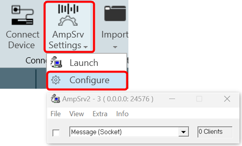

When you start GTT and connect to AmpSrv2, the AmpSrv2 window will show the number of connected clients.
Once you have completed the necessary Ampsrv2 modifications, go to AmpSrv2 Settings and save the Ampsrv2 modifications.
This saved configuration will now be used for this specific device on Connect Device. The saved configuration will also be exported/imported using the GTT project Export/Import functionality.
If no AmpSrv2 settings are connected with the device, the default settings will be used. You can modify the GTT default AmpSrv2 settings. Follow the steps mentioned in the above topic “To changing AmpSrv2 Settings”.
The AmpSrv2 window will appear, and the user can modify the settings, which will be considered the Default Settings for GTT.
In the case of a Discover device, you should first open AmpSrv2 Settings, modify settings as needed, and then click on Discover Device. This modified configuration will be used to discover the device.

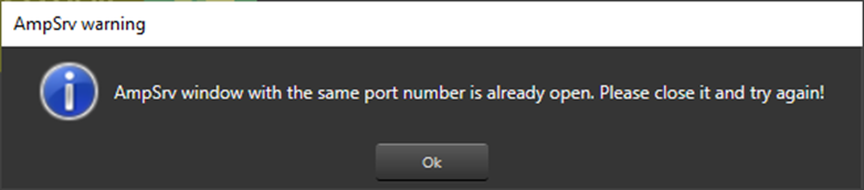

Two AmpSrv2 windows with the same port number cannot be opened or an error message will be displayed.
