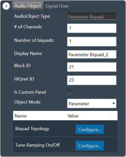

An object can chose to utilize all the default variables or not. However if the object needs more configuration variables, that’s where additional variables come in. A good example is parameter biquad audio object:
  • Channels are used
  • Elements represent number of biquads field
  • Object Mode is the drop down.
However, the parameter biquad object also allows the user to select the filter topology and whether ramping is needed or not. Those two are represented with additional variables. These are fully customizable by the objects.

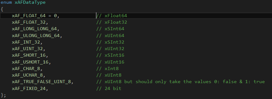

  • Data type for the additional variable
String data type is not supported, as it will add additional bytes to the flash memory. Strings are used only in GTT and not required on target.

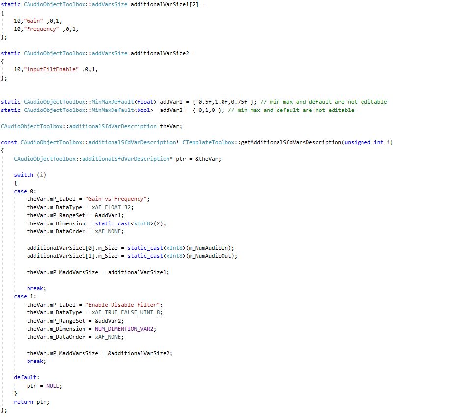

Below is an example of an object that has four additional variables.
  • First additional variable
    • Label : “ Gain Vs Frequency “
    • Data type : Float
    • Defaults : Min Value = 0.5 Max Value = 1.0 and Default value = 0.75
    • Number of dimension = NUM_DIMENTION_VAR1 (2)
    • Data order : xAF_NONE (no specific order required)
    • Dimension details :
      • 1st dimension:
        • Size of 1st dimension : SIZE_ADDVAR_1_XAXIS (10)
        • Label : “Gain“
        • Axis start index : 0
        • Axis increment : 1
      • 2nd dimension:
        • Size of 2nd dimension : SIZE_ADDVAR_1_YAXIS (20)
        • Label : “Frequency“
  • Second additional variable
    • Label : “Enable Disable Filter“
    • Data Type : Int8 / char
    • Defatults : Min Value = 0 Max Value = 1 and Default value = 0
    • Number of dimension = 1
      • 1st dimension
        • Size of 1st dimension : 10
        • Label : “ inputFiltEnable“
  • Third additional variable
    • Label : “ Min Max “
    • Data type : Int
    • Defatults : Min Value = 0 Max Value = 30 and Default value = 5
    • Data order : xAF_ASCENDING (Data has to be entered in ascending order)
      • 1st dimension
        • Size of 1st dimension : 2
        • Label : “ 1st – Min 2nd – Max“
  • Fourth additional variable
    • Label : “ Gain “
    • Data type : Int
    • Defatults : Min Value = -30 Max Value = 20 and Default value = 1
    • Data order : xAF_NONE (Data has to be entered in ascending order)
      • 1st dimension
        • Label : “ Gain “

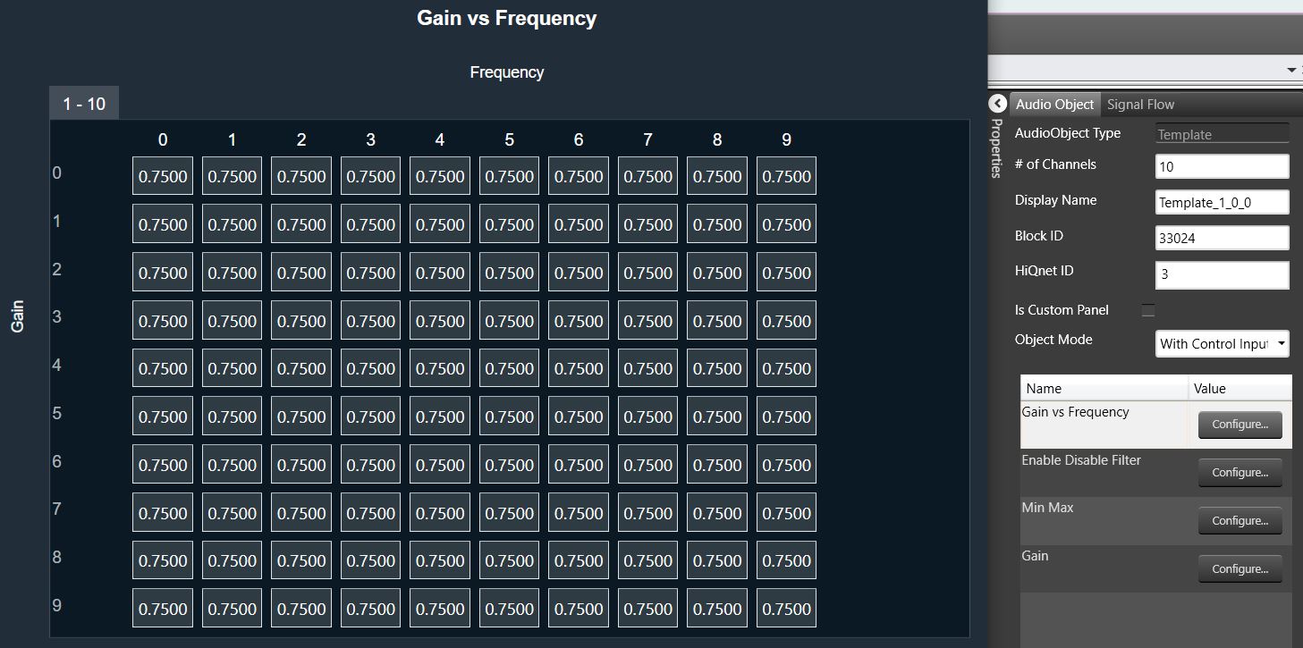

An example of the result in the SFD is shown below, with the configuration of additional variable 1:

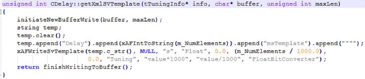

To ease the generation of this data, the xAF has created XML helper functions. These functions can be used when writing getXmlSVTemplate(), getXmlObjectTemplate() functions.
The helper function is shown below for an example where getXmlSVTemplate() for a Delay object is written using writeSvTemplate():
