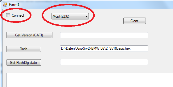

Check whether GTT requests the disconnection by doing the following:
  • Start attached application in parallel to your test automation.
  • Choose corresponding interface inside of the tool and connect to AmpSrv2.
AmpSrv2 Troubleshooting
If GTT disconnects, AmpSrv2 should still be connected to the target device.

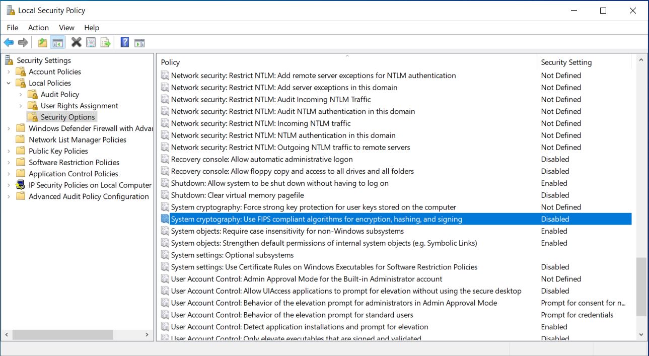

Unable to import/export projects in GTT If the FIPS Algorithm Policy is enabled in the computer, GTT fails to import/export any project.
  1. Close the GTT.
  2. Navigate to the Windows start bar and in the search field enter “secpol.msc”. This action opens the Local Security Policy editor.
  3. Under the Security Settings, navigate to Security Options, and locate the System cryptography setting.

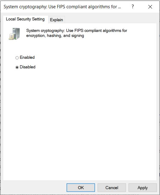

    If the System cryptography setting is enabled, proceed to the next step to disable it.
  4. Double-click on the System Cryptography setting, choose Disabled, and then Apply.
  5. Reboot the computer.
  6. Launch the GTT and try to import/export any project.
