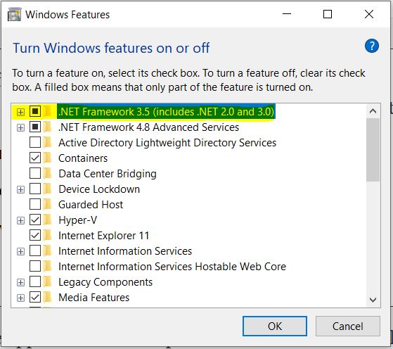

This error occurs if the default .NET 3.5 is not enabled on Windows.
Check if the feature is enabled from Windows features.To do this, follow the steps below:
  1. Go to Control Panel > Programs and Features.
  2. On the left panel, select View Windows features on or off.
  3. Check if the below highlighted feature of .NET is enabled or not.

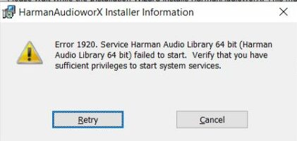

Installer Error Message Description
During installation, the error message below appears.
Solution
This error message appears if there are previous residues of service left.
Follow the steps below:
  1. Click on Abort.
  2. Run services.msc and check if the Harman Audio Library service is in the list.
  3. If it is in the list:
  4. Run CMD (as administrator) and type sc delete “Harman Audio Library”.
Same steps can be used for Harman License Manager as well.

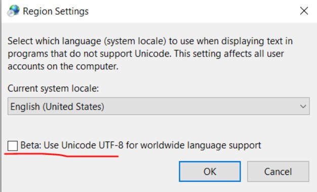

There are chance that the below checkbox is checked. Uncheck this.  This is available in Control Panel -Time & Language > Region Settings.
To reach the above option, go to Control Panel > Clock and Region > Region > Administrative tab.

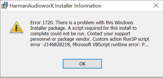

Installation error Description
During installation getting below error.
Solution
  • Before Installing, Go to C:\ProgramData\Harman\GTT folder.
  • Check if AudioLibraries folder exist, if exists delete or rename it.
  • Try installation again.

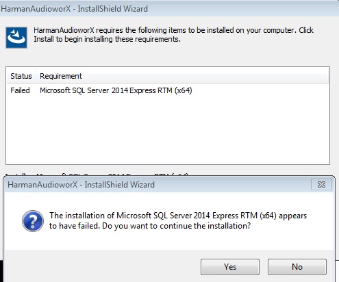

SQL Installation Fails Description
The installer complains that the SQL RTM installation has failed.
Solution
There seems to be another version of SQL Compact edition installed on the box.
  1. Cancel the installation by clicking “No” or click OK.
  2. Restart the machine.
  3. Try the installer setup again.
Microsoft SQL RTM has a rule to check if there is any pending restart on the machine, if pending SQL installation will fail.

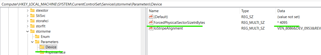

AudioworX_PreReq fails on Windows 11 Description
If the machine has been upgraded from Windows 10 to Windows 11, the AudioworX_PreReq installation fails due to SQL Server Express 2019 incompatibility.
Solution
If the machine has been upgraded from Windows 10 to Windows 11, ensure the following registry key exists before proceeding with the SQL Server Express 2019 installation.
To add the registry key, open Command Prompt as Administrator and run the following command:
REG ADD “HKLM\SYSTEM\CurrentControlSet\Services\stornvme\Parameters\Device” /v “ForcedPhysicalSectorSizeInBytes” /t   REG_MULTI_SZ /d “* 4095” /f
Once you have added the registry key, run Setup_HarmanAudioworX_PreReq_2.2.0.2450.exe.
