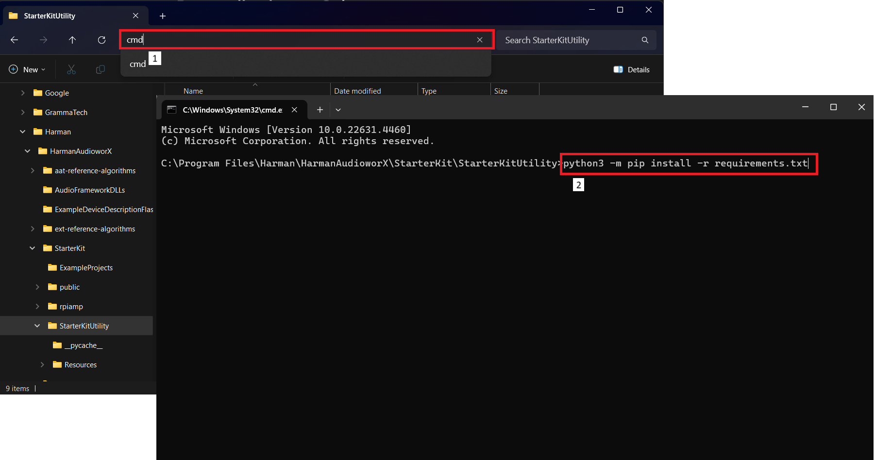

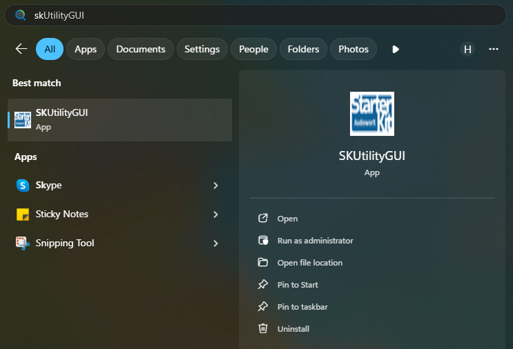

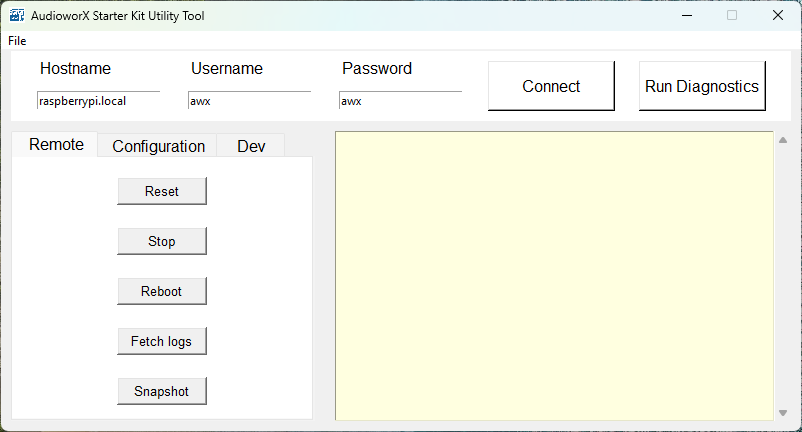

The GTT installation includes the AudioworX Starter Kit Utility tool (SKUtility), a graphical application that can be used to remotely operate the Starter Kit hardware over the network, for actions like verifying hardware connections, audio device configuration, resetting the AWX Amp application running on the Raspberry Pi, rebooting the Raspberry Pi, etc. This tool is described in detail in SKUtility Tool – Graphical Application and can be found in the following directory (default GTT installation folder):
C:\Program Files\Harman\HarmanAudioworX\StarterKit\StarterKitUtility\SKUtilityGUI.exe
The SKUtility tool can also be accessed directly from the Start-Menu by pressing the “Windows” key on the keyboard, followed by the keyword “SKUtilityGUI”. Below is a screenshot showing the same.
The SKUtility Tool is also available as a command-line application written in Python 3.12, installed in the same directory as the graphical application. For more information, refer to Starter Kit Utility Tool (SKUtility) Overview.
