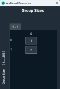

Additional Parameters The ControlOut audio object has one additional configuration parameter — Group Sizes

Group Sizes This is an additional parameter which is an array with a length equal to Number of Control Inputs.
Each value in this array is the size of the corresponding control.
Example: [1,2] would mean the first control input is a single control, but the second is a block control of size 2.
