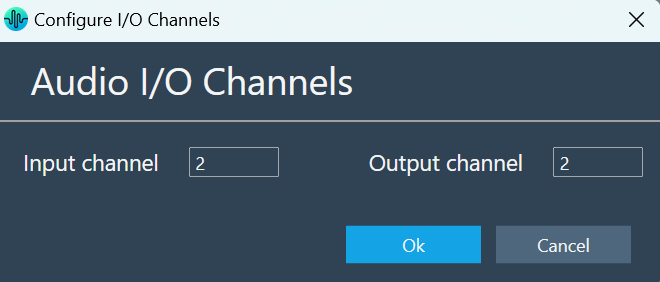

      This action opens the Configure I/O Channels message box.
    2. Enter the Input channel and Output channel value and click OK. The audio objects inside the signal flow designer are filtered based on the Data Format of the core.

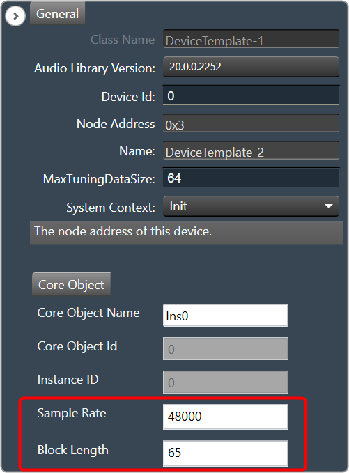

    3. Select the Xaf Instance and configure the core object properties; Sample Rate and Block Length.
      • Sample Rate: This sample rate will be applied to all the audio blocks in the signal flow
      • Block Length: It is required internally by the xAF framework.
        Graphical user interface Description automatically generated
    4. Once you configured the Xaf Instance core object properties, click Save.

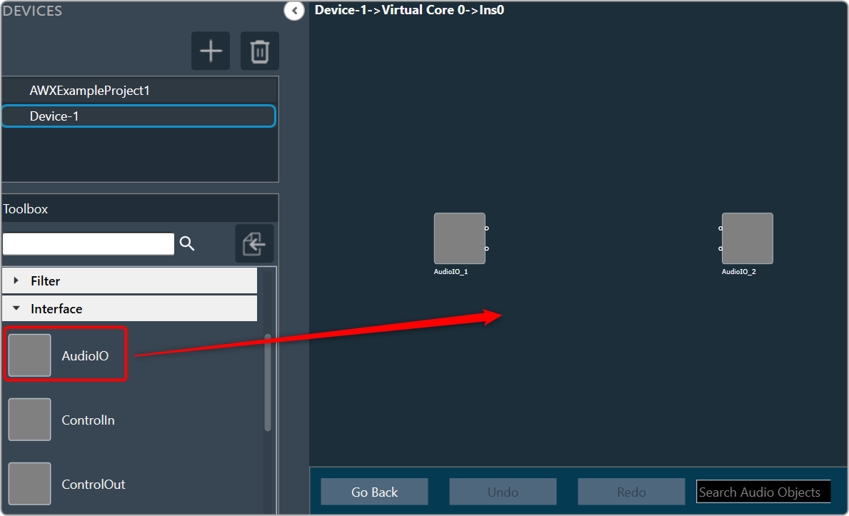

    6. On the Signal Flow Designer, go to the Toolbox section, expand Interface, and drag AudioIO audio object to the design canvas. Similarly, add another AudioIO audio object to the design canvas.
       – When adding an xAF instance to a device that is already online, this AudioIO can be added. Thus, this step is only necessary if these two AudioIO objects are absent.
      – The toolbox will filter audio objects based on the core type of the physical core where this Framework instance is added.
      The audio object will be marked with an exclamation mark to indicate that it cannot be used for building signal flow. You can hover over it to see which core types are supported.

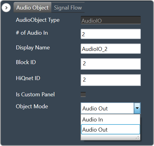

    7. Select one of the AudioIO audio object and set the Object Mode parameter to Audio In. Similarly, select another AudioIO audio object and set the Object Mode parameter to Audio Out.

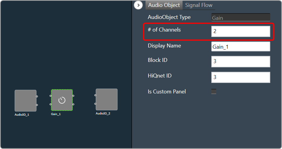

    9. Select the Gain audio object and set # of channels parameter to 2.
      The number of channels determines the number of connectors that will be assigned to the AO. In GTT, you can allocate as many channels as required for your device.

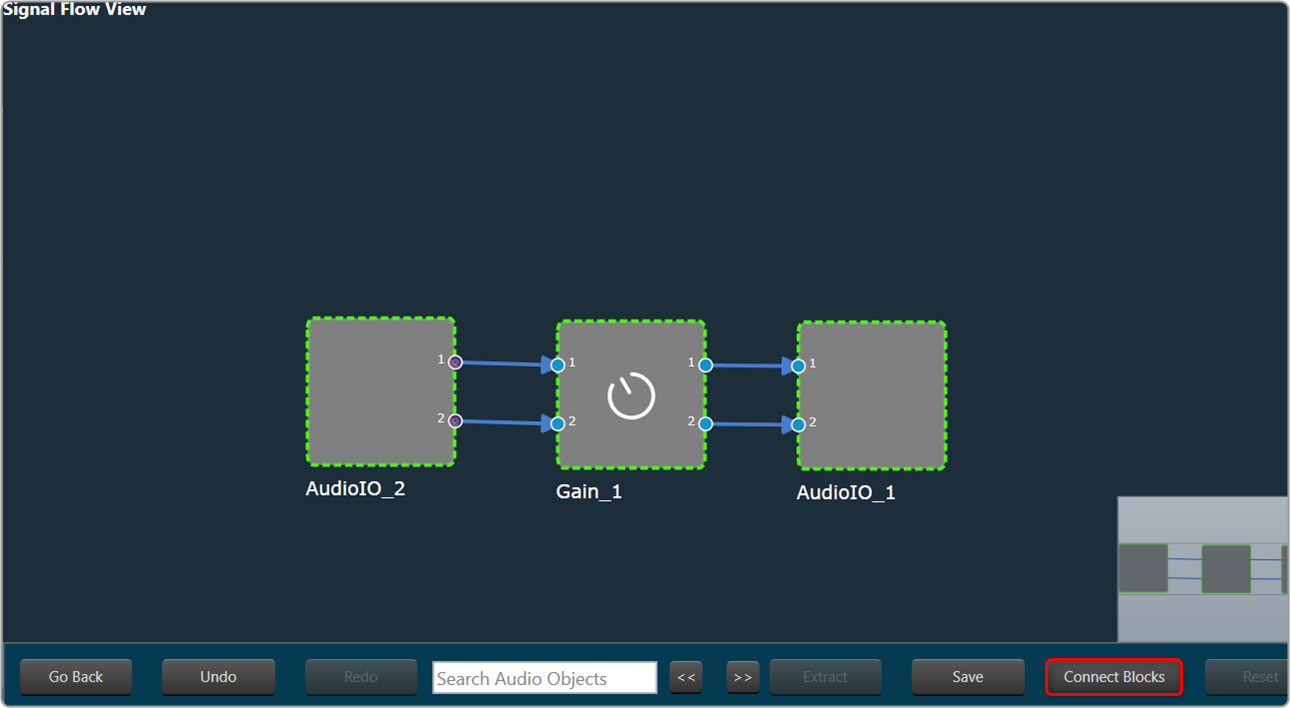

    10. Press CTL+A or hold the CTRL key, to select an individual audio object from the Signal Flow view, and click Connect Blocks to connect all the audio object.
      You can connect the pin manually by establishing a connection between each pin of the AO.
      Now you have an input and output object, as well as an object to tune gain, invert, and mute parameters for each channel of the signal flow designer.

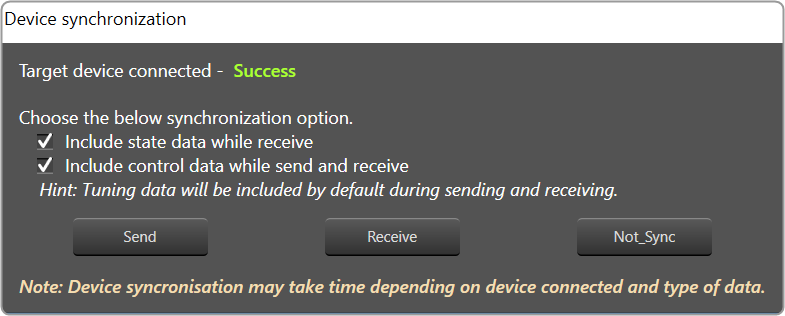

    14. Switch to Device Designer tab and click on Connect Device to connect to the device.
    15. Device synchronization dialogue box will appear, enable the desired synchronization option, and click Send.
