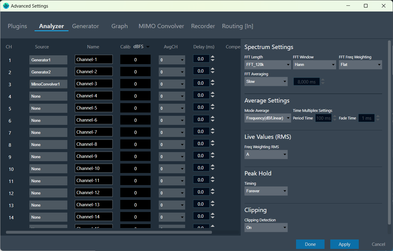

  6. Go to the Analyzer tab and select Plugin Host (MIMO convolver) output as the channel source.
  7. Set the Channel source (such as Generator1, PluginHost1, and MimoConvolver1) to display in the chart.
  8. Once the settings have been updated, click Done.
  9. Connect to the device through Plugin Host. For more details, refer to Plugin Host Setting.
  10. Open Channels, and assign channels to Graph A and Graph B.
A chart with Genertor1, PluginHost1, and MimoConvolver1 outputs appears.
