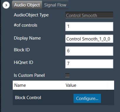

Display Name Display name of the Control Smooth audio object in signal flow design. It can be changed based on the intended usage of the object.

Additional Parameter
Parameter Description

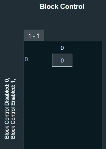

Block Control This variable is used to enable or disable block control.
  • 0 – Block Control Disabled (Default)
  • 1 – Block Control Enabled
