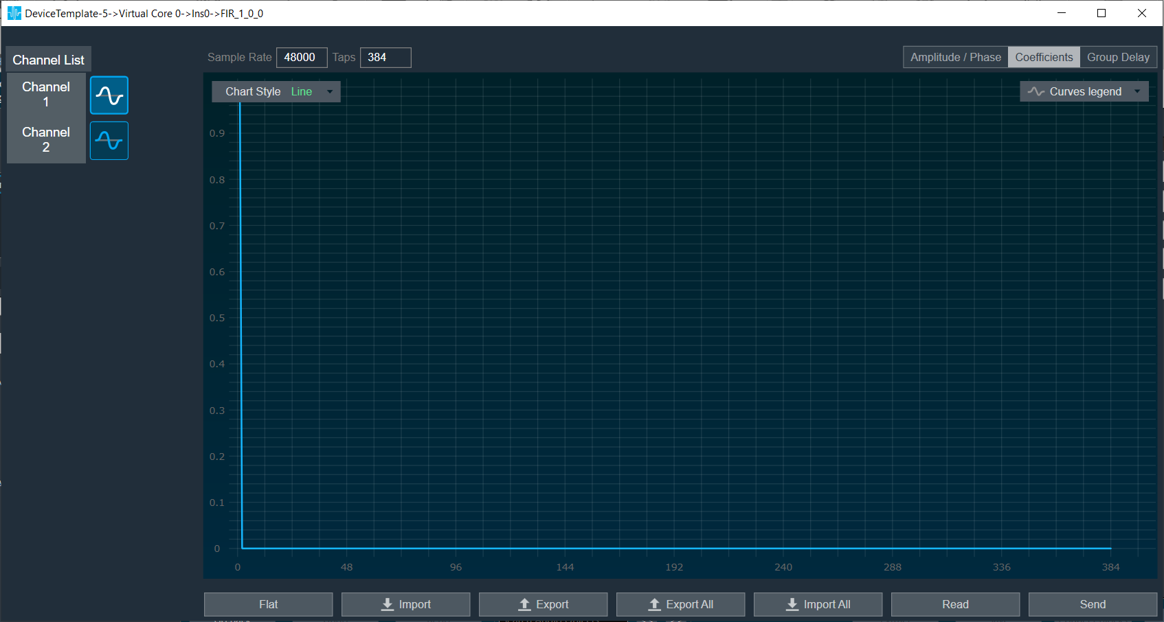

FIR Filter native panel allows you to configure the Mode of each enabled filter and to load coefficients as well. In order to see the graphs, you need to import coefficients. Use ‘Import’ or ‘Import All’ option  to import coefficients.
To open the native panel, double-click on the FIR Filter audio object in the signal flow designer.

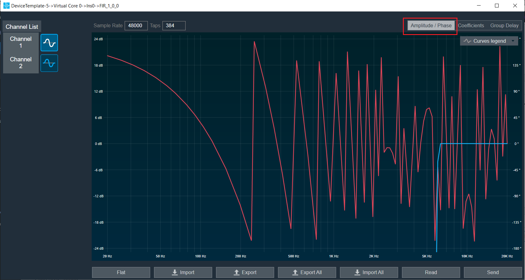

Amplitude/Phase: When the coefficients are given and “Amplitude/Phase” option is selected, the graph display the value.

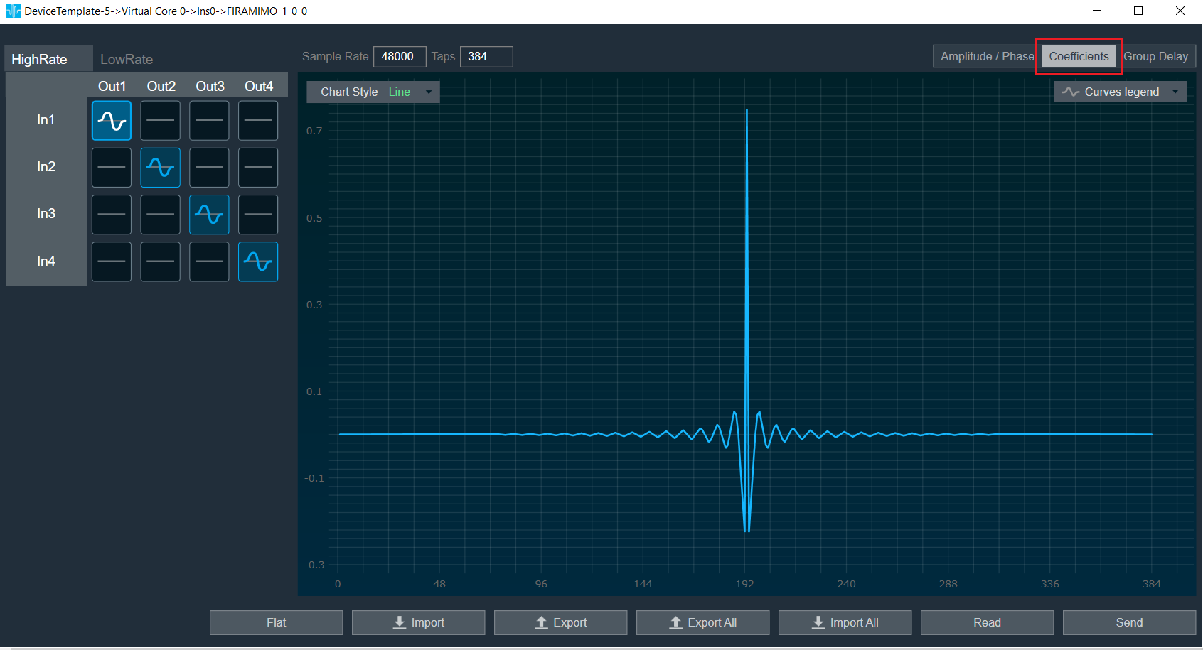

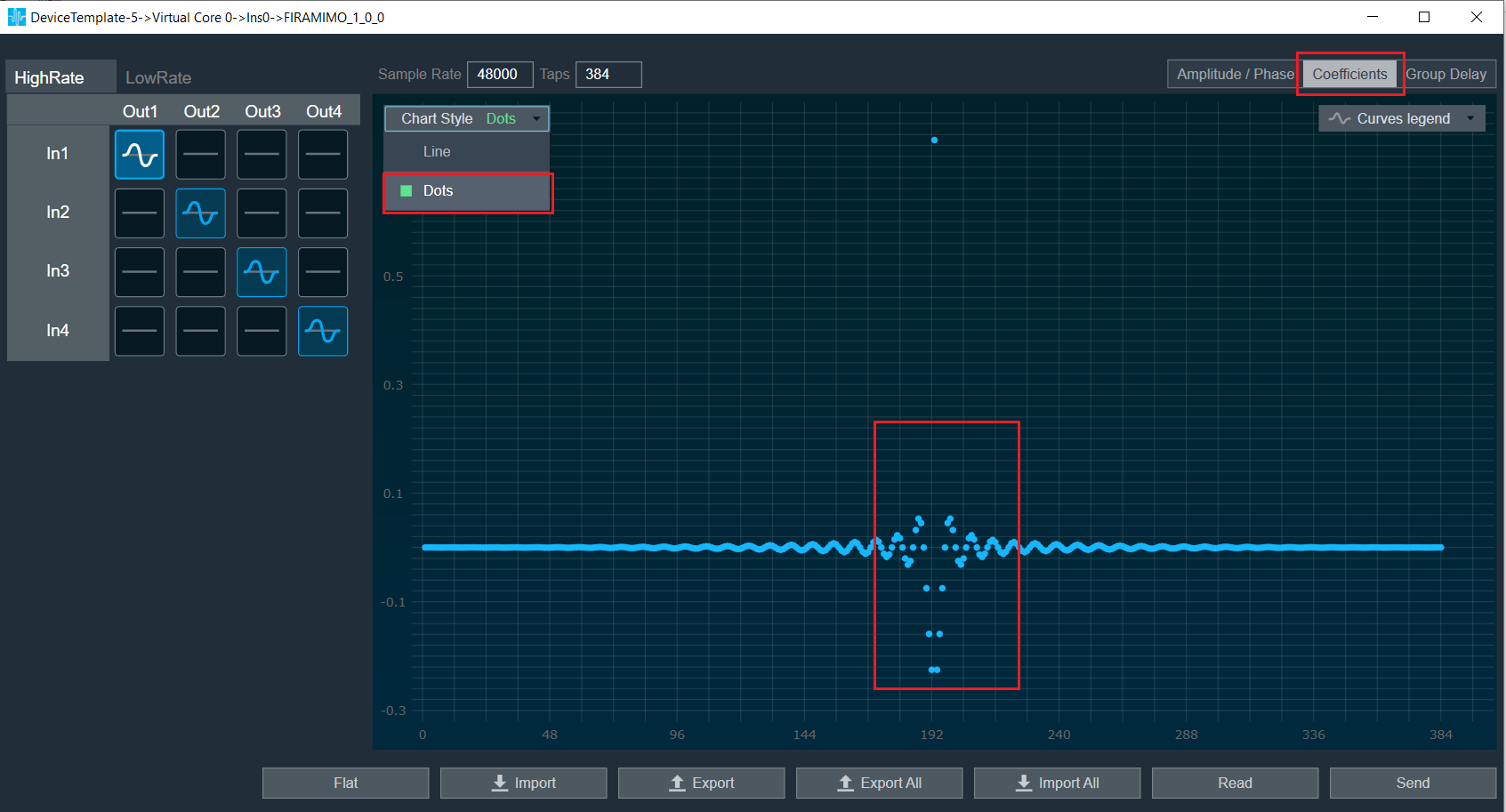

Coefficients:  When the coefficients are given and the “Coefficients” option is selected, the graph displays the values as per below figure. You can change the graph style using the “Chart Style” option.
Line chart style: when “Chart Style” selected as Line, the Coefficients graph. A screen shot of a computer Description automatically generated
Dot chart style: when “Chart Style” selected as Dot, the Coefficients graph. A screenshot of a computer Description automatically generated
