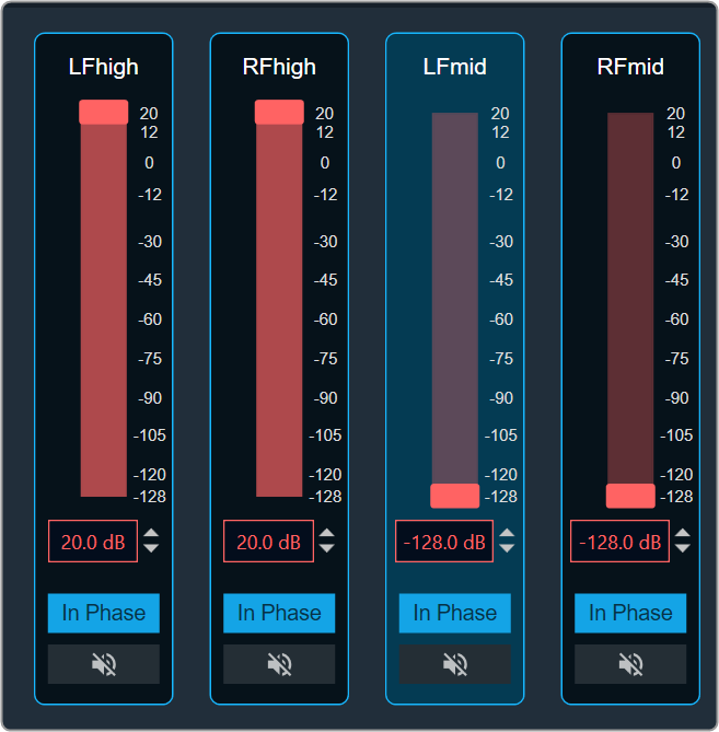

  • Threshold Values: The maximum and minimum threshold values are derived from the ParameterStore in GTT. Once either of the threshold values is reached, the Gain value bar will change to the color red.

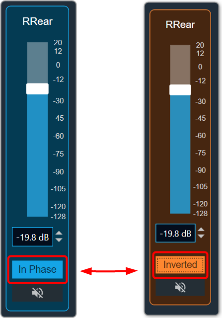

  • In Phase / Invert: To invert or Inphase the gain value
    • Click on the In Phase to invert the gain value.
    • Click on the Inverted to in phase the gain value.

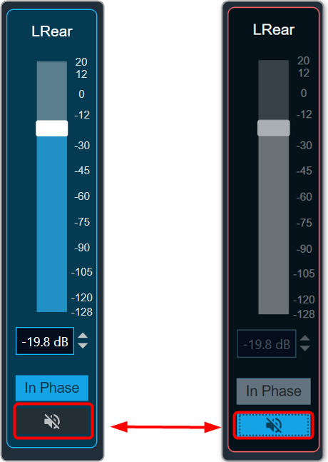

  • Mute: The Mute button sets the gain value to a minimum gain value. Even if the gain value is muted, you can change it.
    A screenshot of a computer Description automatically generated with low confidence

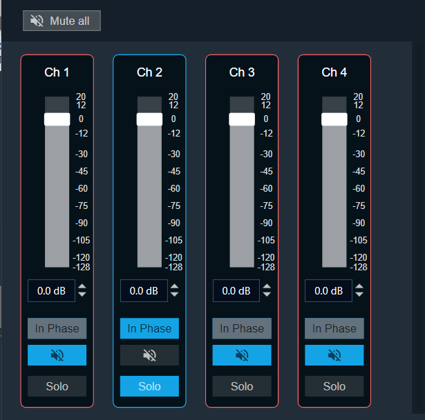

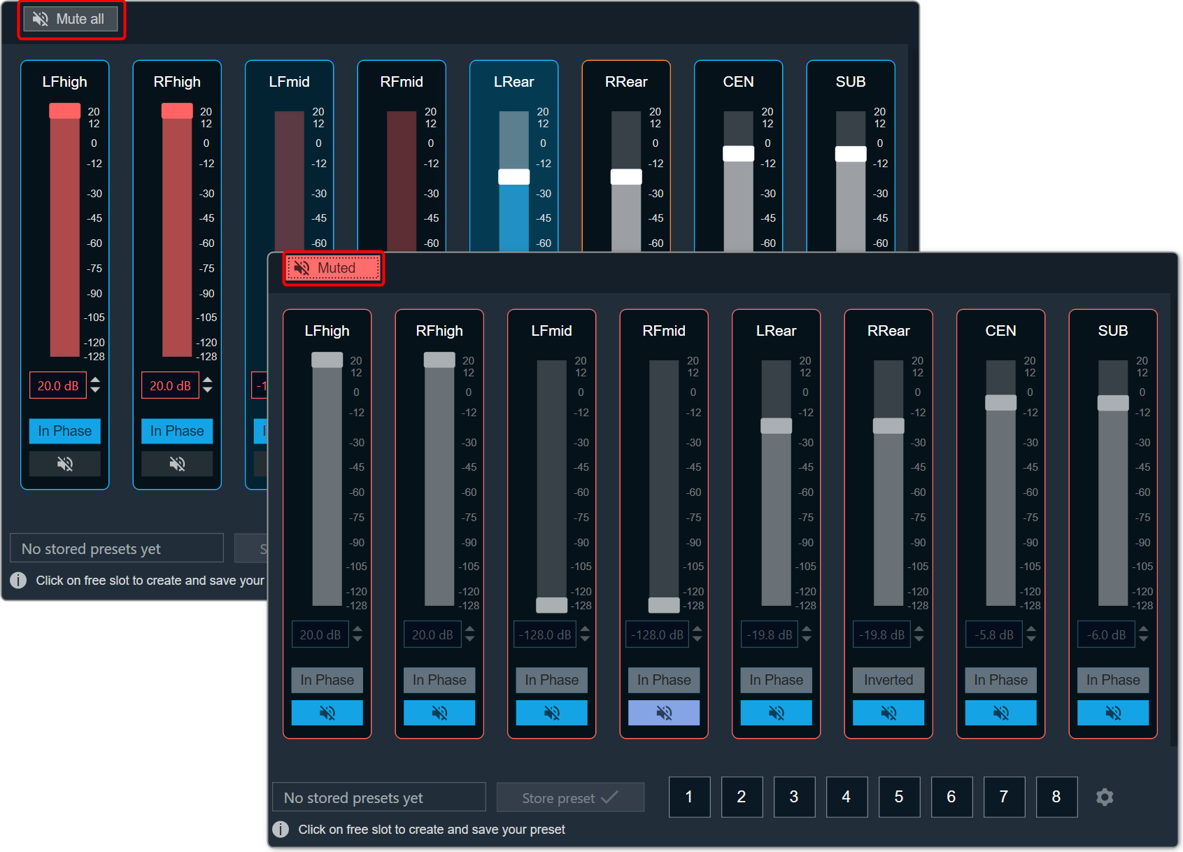

  • Mute all: The Mute all button sets all gain values to minimum gain values. If all gains are muted, the Mute all button will change to Muted.
  • Solo: The Solo button mutes all the channel except the selected one. Additionally, the phase of all the muted channels get disabled. Click on the Solo button again, to unmute all the channels.
