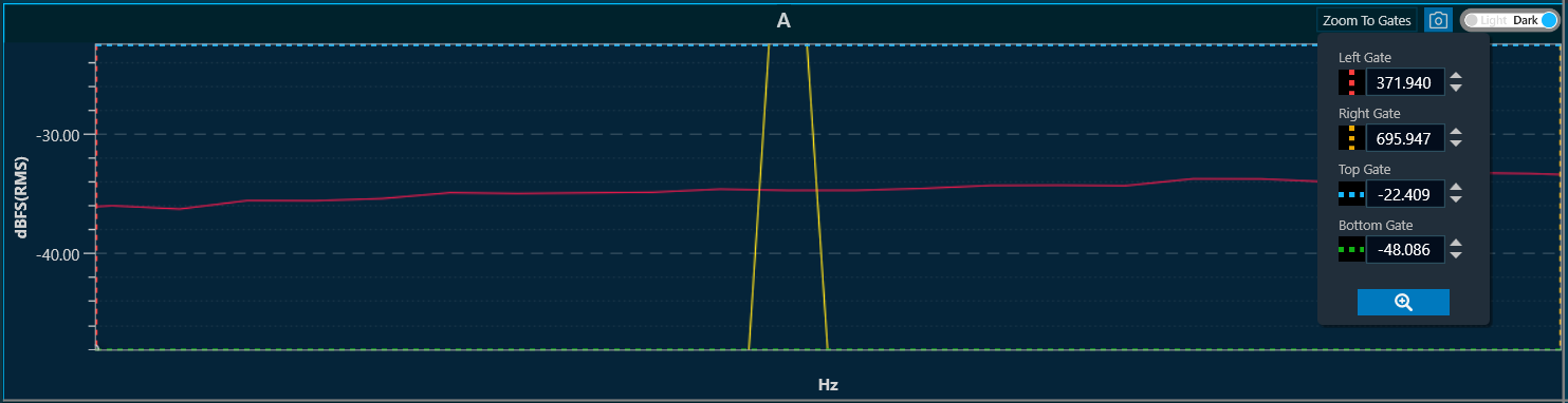

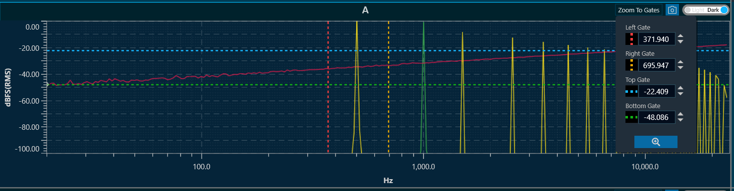

Zoom To Gates
The Zoom To Gates feature allows you to zoom to a specific area in the chart using four gates (two horizontal and two vertical) which you can position by selecting and dragging them to the desired position or if you prefer by placing the value of the position in the chart in the text boxes.
By default, when there are no Curves in chart the values from gates are the limit of visible range of current chart. Only for old projects with that has a loaded curve, the gates will set on the limit of visible range included data.
The Gates are supported for Time, Spectrum, Multiplexer, Phase, Delay and IR modes.
When you move each gate, the current position will be reflected in each value referred to the bottom of the chart identified with a color.
To zoom in on the area between the four lines: Click on the button at the end of the text boxes with the current position values ​​of the gates “Done” and the chart area will automatically position the gates within the limits of the chart and the zoom to the area will have been performed.
To return to the default value you only have to double click on any area of ​​the chart.
All gate values ​​will be persistent across projects, meaning you can save their last configuration to be exported or used later with specific values.
